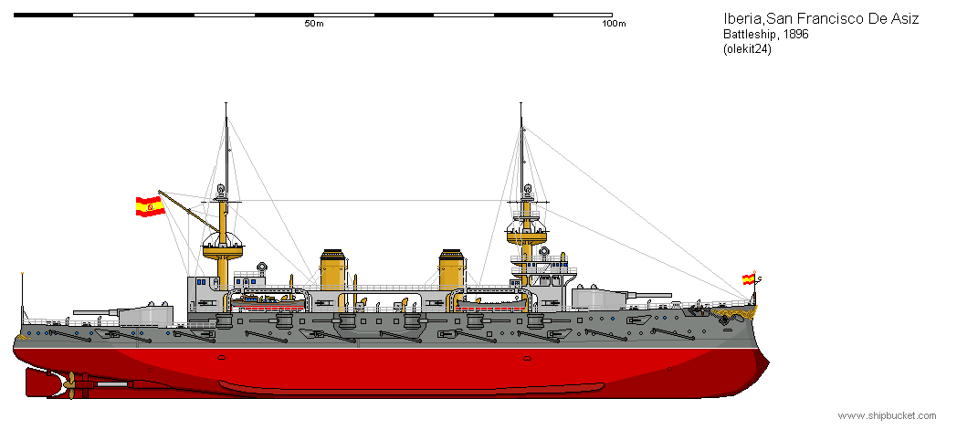

San Francisco class (1897)
Sagami (San Francisco), PURCHASED 1915
Suwo (San Antonio), PURCHASED 1915
Hizen (San Sebastian) PURCHASED 1916

Sagami (San Francisco de Asiz, 1897), PURCHASED 1915
Suwo (San Antonio, 1897), PURCHASED 1915
San Francisco De Asiz, Spain Battleship laid down 1897
Displacement:
   12 010 t light; 12 616 t standard; 13 720 t normal; 14 603 t full load
Dimensions: Length (overall / waterline) x beam x draught (normal/deep)
   (408,01 ft / 402,10 ft) x 74,11 ft x (25,30 / 26,67 ft)
   (124,36 m / 122,56 m) x 22,59 m  x (7,71 / 8,13 m)
Armament:
      4 - 12,01" / 305 mm 40,0 cal guns - 829,70lbs / 376,34kg shells, 95 per gun
     Breech loading guns in turret on barbette mounts, 1897 Model
     1 x Twin mount on centreline, forward deck forward
     1 x Twin mount on centreline, aft deck aft
      12 - 6,30" / 160 mm 40,0 cal guns - 119,78lbs / 54,33kg shells, 150 per gun
     Breech loading guns in casemate mounts, 1897 Model
     12 x Single mounts on sides, evenly spread
      20 - 2,95" / 75,0 mm 40,0 cal guns - 12,34lbs / 5,60kg shells, 200 per gun
     20 x Single mounts on sides, evenly spread
      12 hull mounts in casemates- Limited use in heavy seas
      12 - 2,24" / 57,0 mm 45,0 cal guns - 5,70lbs / 2,58kg shells, 250 per gun
      8 raised mounts
      Weight of broadside 5 071 lbs / 2 300 kg
Armour:
   - Belts:      Width (max)   Length (avg)      Height (avg)
   Main:   12,0" / 305 mm   259,19 ft / 79,00 m   11,15 ft / 3,40 m
   Ends:   3,94" / 100 mm   117,95 ft / 35,95 m   10,50 ft / 3,20 m
     24,97 ft / 7,61 m Unarmoured ends
   Upper:   3,54" / 90 mm   226,35 ft / 68,99 m   7,22 ft / 2,20 m
     Main Belt covers 99% of normal length
   - Gun armour:   Face (max)   Other gunhouse (avg)   Barbette/hoist (max)
   Main:   12,0" / 305 mm   4,72" / 120 mm      12,0" / 305 mm
   2nd:   5,51" / 140 mm         -               -
   5th:   0,98" / 25 mm         -               -
   - Armoured deck - multiple decks:
   For and Aft decks: 2,17" / 55 mm
   Forecastle: 2,17" / 55 mm  Quarter deck: 2,17" / 55 mm
   - Conning towers: Forward 12,01" / 305 mm, Aft 5,91" / 150 mm
Machinery:
   Coal fired boilers, complex reciprocating steam engines,
   Direct drive, 2 shafts, 18 386 ihp / 13 716 Kw = 19,39 kts
   Range 6 300nm at 10,00 kts
   Bunker at max displacement = 1 987 tons (100% coal)
Complement:
   633 - 823
Cost:
   £1,193 million / $4,770 million
Distribution of weights at normal displacement:
   Armament: 763 tons, 5,6%
      - Guns: 763 tons, 5,6%
   Armour: 4 068 tons, 29,6%
      - Belts: 2 019 tons, 14,7%
      - Armament: 918 tons, 6,7%
      - Armour Deck: 910 tons, 6,6%
      - Conning Towers: 221 tons, 1,6%
   Machinery: 3 014 tons, 22,0%
   Hull, fittings & equipment: 4 025 tons, 29,3%
   Fuel, ammunition & stores: 1 710 tons, 12,5%
   Miscellaneous weights: 140 tons, 1,0%
      - Hull above water: 140 tons
Overall survivability and seakeeping ability:
   Survivability (Non-critical penetrating hits needed to sink ship):
     15 659 lbs / 7 103 Kg = 18,1 x 12,0 " / 305 mm shells or 1,9 torpedoes
   Stability (Unstable if below 1.00): 1,26
   Metacentric height 4,9 ft / 1,5 m
   Roll period: 14,1 seconds
   Steadiness   - As gun platform (Average = 50 %): 96 %
         - Recoil effect (Restricted arc if above 1.00): 0,68
   Seaboat quality  (Average = 1.00): 1,60
Hull form characteristics:
   Hull has low quarterdeck ,
     a ram bow and a cruiser stern
   Block coefficient (normal/deep): 0,637 / 0,643
   Length to Beam Ratio: 5,43 : 1
   'Natural speed' for length: 20,05 kts
   Power going to wave formation at top speed: 53 %
   Trim (Max stability = 0, Max steadiness = 100): 60
   Bow angle (Positive = bow angles forward): -6,00 degrees
   Stern overhang: -6,14 ft / -1,87 m
   Freeboard (% = length of deck as a percentage of waterline length):
            Fore end,    Aft end
      - Forecastle:   27,00%,  22,97 ft / 7,00 m,  21,00 ft / 6,40 m
      - Forward deck:   30,00%,  21,00 ft / 6,40 m,  20,34 ft / 6,20 m
      - Aft deck:   17,00%,  20,34 ft / 6,20 m,  20,34 ft / 6,20 m
      - Quarter deck:   26,00%,  12,14 ft / 3,70 m,  12,47 ft / 3,80 m
      - Average freeboard:      18,74 ft / 5,71 m
Ship space, strength and comments:
   Space   - Hull below water (magazines/engines, low = better): 96,6%
