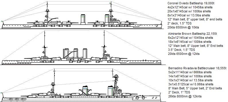

Which, if any of these would you build?
Started by Sachmle, June 24, 2008, 09:51:13 PM
Images based on parts by Wes Wilson, modified by me.
Valles
Overall, I like the Coronel. The thinner deck is a strive vs. Almirante, but the main battery layout is much better. Also, cheaper. Rivadavia would never even be in the running.

I'm not excited by neither.
The battleships are simply too weakly armed. Such hulls, or minimally larger, with a minimal cut of speed, can carry 8-10 13,5" guns.
The Armoured Cruiser (Almirante Seydlitz?) does carry some merit.
It's becoming very obvious that w/o bigger guns I'm going to be out of the battleship game. Perhaps it's for the best, I really don't have the BP to be building them. Maybe I'll switch to a Juene Ecole navy. Build a mass of D-100 & D-200s and a nice group of Neuva and Toreador PCs.

Quote from: Sachmle on June 24, 2008, 11:15:08 PM
Why not just buy the guns aboard? If only needing 8-10 big guns, I think it would be cheaper then developing them yourself even if the seller has a 100% profit margin.
Otherwise i am inclined to agree with borys, none of the designs are really a god investment in my mind.
They are all lacking in horizontal protection, and/or hitting power.

The battleships pack the same firepower as the Swiss Independance class at a higher cost but much lower speed (7 knots). I wouldn't bother with any of them. The battlecruiser on the other hand... Now THAT ship I would build.
Jefgte
#6
Nice drawings  ;)
I agree with Borys, for a 1912 LD, they have not enough fire power
A full boardside with 4T2x13"5 (Oviedo)
or 5T2x12" (Rivadavia) is the minimum.
(6T2x12" are better).
I prefer Rivadavia with BB protection

Rivadavia with 8x11", 27kts and 1.5" TBH. I'd build two of her class instead of the slow cruisers on the other thread.

Quote from: P3D on June 25, 2008, 04:11:56 AM
Something like this?

Jefgte
What do you want to built
a BB or a BC ?
Jef  ;)

BOTH!! :D Unfortunately I probably can't afford either.
Ahoj!
Looks good.
But I'd scale back armour, to:
- Belt - 6-7"
- turret face - 8"
- barbettes - 7"
I can't, given my current location, see the image you posted at the top of the thread.  However, my comments would generally be:
-If you're going to lose the numbers game anyway, it's better to focus on the quality of the ships you do build.
-Consult with your larger allies, who may be able to help out in some of the non-core functions/areas you need covered.  For example, you might be able to concentrate on battleships if assured that Gran Colombia would, in certain scenarios, provide armored cruiser support to you.

Coronel Oviedo, NUS Battleship laid down 1914 (Engine 1912)
Displacement:
   19,270 t light; 20,382 t standard; 21,393 t normal; 22,202 t full load
Dimensions: Length overall / water x beam x draught
   557.00 ft / 554.00 ft x 92.40 ft x 28.00 ft (normal load)
   169.77 m / 168.86 m x 28.16 m  x 8.53 m
Armament:
      4 - 12.00" / 305 mm guns (2x2 guns), 1,045.00lbs / 474.00kg shells, 1913 Model
     Breech loading guns in turrets (on barbettes)
     on centreline ends, evenly spread
     on centreline, all amidships
      20 - 6.00" / 152 mm guns in single mounts, 100.00lbs / 45.36kg shells, 1913 Model
     Breech loading guns in casemate mounts
     on side ends, evenly spread
     20 guns in hull casemates - Limited use in heavy seas
      8 - 3.00" / 76.2 mm guns in single mounts, 13.50lbs / 6.12kg shells, 1913 Model
     Quick firing guns in deck mounts
     on centreline, evenly spread, all raised mounts
   Weight of broadside 10,468 lbs / 4,748 kg
   Shells per gun, main battery: 110
   4 - 18.0" / 457.2 mm submerged torpedo tubes
Armour:
   - Belts:      Width (max)   Length (avg)      Height (avg)
   Main:   12.0" / 305 mm   360.00 ft / 109.73 m   16.00 ft / 4.88 m
   Ends:   8.00" / 203 mm   194.00 ft / 59.13 m   12.00 ft / 3.66 m
   Upper:   8.00" / 203 mm   360.00 ft / 109.73 m   8.00 ft / 2.44 m
     Main Belt covers 100 % of normal length
   - Torpedo Bulkhead:
      1.50" / 38 mm   360.00 ft / 109.73 m   32.00 ft / 9.75 m
   - Gun armour:   Face (max)   Other gunhouse (avg)   Barbette/hoist (max)
   Main:   13.0" / 330 mm   6.00" / 152 mm      12.0" / 305 mm
   2nd:   13.0" / 330 mm   6.00" / 152 mm      12.0" / 305 mm
   3rd:   6.00" / 152 mm   4.00" / 102 mm      1.00" / 25 mm
   - Armour deck: 2.00" / 51 mm, Conning tower: 12.00" / 305 mm
Machinery:
   Coal and oil fired boilers, steam turbines,
   Electric motors, 2 shafts, 23,557 shp / 17,573 Kw = 20.00 kts
   Range 6,500nm at 10.00 kts
   Bunker at max displacement = 1,821 tons (58% coal)
Complement:
   883 - 1,149
Cost:
   £1.939 million / $7.755 million
Distribution of weights at normal displacement:
   Armament: 1,148 tons, 5.4 %
   Armour: 8,861 tons, 41.4 %
      - Belts: 4,725 tons, 22.1 %
      - Torpedo bulkhead: 639 tons, 3.0 %
      - Armament: 2,009 tons, 9.4 %
      - Armour Deck: 1,288 tons, 6.0 %
      - Conning Tower: 199 tons, 0.9 %
   Machinery: 992 tons, 4.6 %
   Hull, fittings & equipment: 7,775 tons, 36.3 %
   Fuel, ammunition & stores: 2,123 tons, 9.9 %
   Miscellaneous weights: 495 tons, 2.3 %
Overall survivability and seakeeping ability:
   Survivability (Non-critical penetrating hits needed to sink ship):
     32,901 lbs / 14,924 Kg = 38.1 x 12.0 " / 305 mm shells or 6.5 torpedoes
   Stability (Unstable if below 1.00): 1.17
   Metacentric height 5.9 ft / 1.8 m
   Roll period: 15.9 seconds
   Steadiness   - As gun platform (Average = 50 %): 70 %
         - Recoil effect (Restricted arc if above 1.00): 0.41
   Seaboat quality  (Average = 1.00): 1.35
Hull form characteristics:
   Hull has a flush deck
   Block coefficient: 0.522
   Length to Beam Ratio: 6.00 : 1
   'Natural speed' for length: 23.54 kts
   Power going to wave formation at top speed: 41 %
   Trim (Max stability = 0, Max steadiness = 100): 52
   Bow angle (Positive = bow angles forward): 10.63 degrees
   Stern overhang: -2.00 ft / -0.61 m
   Freeboard (% = measuring location as a percentage of overall length):
      - Stem:      16.00 ft / 4.88 m
      - Forecastle (15 %):   16.00 ft / 4.88 m
      - Mid (50 %):      16.00 ft / 4.88 m
      - Quarterdeck (15 %):   16.00 ft / 4.88 m
      - Stern:      16.00 ft / 4.88 m
      - Average freeboard:   16.00 ft / 4.88 m
   Ship tends to be wet forward
Ship space, strength and comments:
   Space   - Hull below water (magazines/engines, low = better): 77.9 %
      - Above water (accommodation/working, high = better): 120.2 %
   Waterplane Area: 34,816 Square feet or 3,235 Square metres
   Displacement factor (Displacement / loading): 104 %
   Structure weight / hull surface area: 165 lbs/sq ft or 805 Kg/sq metre
   Hull strength (Relative):
      - Cross-sectional: 0.95
      - Longitudinal: 1.55
      - Overall: 1.00
   Hull space for machinery, storage, compartmentation is excellent
   Room for accommodation and workspaces is excellent
   Ship has slow, easy roll, a good, steady gun platform
   Good seaboat, rides out heavy weather easily
250t F/C
25t W/T
20t Torpedoes
200t Construction Reserve
__________________________________________________________________
Bernadino Rivadavia, NUS Armoured Cruiser laid down 1914 (Engine 1912)
Displacement:
   18,555 t light; 19,507 t standard; 20,987 t normal; 22,171 t full load
   540.00 ft / 540.00 ft x 88.00 ft x 26.50 ft (normal load)
   164.59 m / 164.59 m x 26.82 m  x 8.08 m
Armament:
      6 - 11.00" / 279 mm guns (3x2 guns), 666.00lbs / 302.09kg shells, 1914 Model
     on centreline ends, majority aft, 1 raised mount aft - superfiring
      4 - 11.00" / 279 mm guns (2x2 guns), 666.00lbs / 302.09kg shells, 1914 Model
      14 - 6.00" / 152 mm guns in single mounts, 100.00lbs / 45.36kg shells, 1906 Model
     Quick firing guns in casemate mounts
     on side, evenly spread
     14 guns in hull casemates - Limited use in heavy seas
      10 - 3.00" / 76.2 mm guns in single mounts, 13.50lbs / 6.12kg shells, 1905 Model
     10 guns in hull casemates - Limited use in heavy seas
      3 - 0.50" / 12.7 mm guns in single mounts, 0.06lbs / 0.03kg shells, 1905 Model
     Machine guns in deck mounts
     on centreline, all aft, all raised mounts - superfiring
   Weight of broadside 8,195 lbs / 3,717 kg
   2 - 18.0" / 457.2 mm submerged torpedo tubes
Armour:
   Main:   8.00" / 203 mm   372.56 ft / 113.56 m   14.00 ft / 4.27 m
   Ends:   2.00" / 51 mm   167.41 ft / 51.03 m   14.00 ft / 4.27 m
   Upper:   5.00" / 127 mm   372.56 ft / 113.56 m   8.00 ft / 2.44 m
     Main Belt covers 106 % of normal length
   - Torpedo Bulkhead:
      1.00" / 25 mm   372.56 ft / 113.56 m   28.00 ft / 8.53 m
   Main:   11.0" / 279 mm   5.00" / 127 mm      10.0" / 254 mm
   2nd:   11.0" / 279 mm   5.00" / 127 mm      10.0" / 254 mm
   3rd:   4.00" / 102 mm   2.00" / 51 mm      1.00" / 25 mm
   4th:   2.00" / 51 mm   1.00" / 25 mm      1.00" / 25 mm
   - Armour deck: 2.00" / 51 mm, Conning tower: 10.00" / 254 mm
Machinery:
   Oil fired boilers, steam turbines,
   Electric motors, 4 shafts, 66,765 shp / 49,806 Kw = 26.00 kts
   Range 8,000nm at 12.00 kts
   Bunker at max displacement = 2,663 tons
Complement:
   871 - 1,133
Cost:
   £2.410 million / $9.641 million
   Armament: 1,038 tons, 4.9 %
   Armour: 6,465 tons, 30.8 %
      - Belts: 2,626 tons, 12.5 %
      - Torpedo bulkhead: 386 tons, 1.8 %
      - Armament: 2,024 tons, 9.6 %
      - Armour Deck: 1,266 tons, 6.0 %
      - Conning Tower: 164 tons, 0.8 %
   Machinery: 2,662 tons, 12.7 %
   Hull, fittings & equipment: 8,040 tons, 38.3 %
   Fuel, ammunition & stores: 2,432 tons, 11.6 %
   Miscellaneous weights: 350 tons, 1.7 %
     28,308 lbs / 12,840 Kg = 42.5 x 11.0 " / 279 mm shells or 4.2 torpedoes
   Stability (Unstable if below 1.00): 1.10
   Metacentric height 5.0 ft / 1.5 m
   Roll period: 16.6 seconds
   Steadiness   - As gun platform (Average = 50 %): 60 %
         - Recoil effect (Restricted arc if above 1.00): 0.62
   Seaboat quality  (Average = 1.00): 1.16
   Hull has rise forward of midbreak
   Block coefficient: 0.583
   Length to Beam Ratio: 6.14 : 1
   'Natural speed' for length: 23.24 kts
   Power going to wave formation at top speed: 57 %
   Bow angle (Positive = bow angles forward): -7.13 degrees
   Stern overhang: -4.00 ft / -1.22 m
      - Stem:      24.00 ft / 7.32 m
      - Forecastle (16 %):   24.00 ft / 7.32 m
      - Mid (84 %):      24.00 ft / 7.32 m (16.00 ft / 4.88 m aft of break)
      - Quarterdeck (16 %):   16.00 ft / 4.88 m
      - Average freeboard:   22.74 ft / 6.93 m
   Space   - Hull below water (magazines/engines, low = better): 106.1 %
      - Above water (accommodation/working, high = better): 179.6 %
   Waterplane Area: 34,216 Square feet or 3,179 Square metres
   Displacement factor (Displacement / loading): 103 %
   Structure weight / hull surface area: 163 lbs/sq ft or 793 Kg/sq metre
      - Cross-sectional: 0.92
      - Longitudinal: 2.07
      - Overall: 1.00
   Hull space for machinery, storage, compartmentation is adequate
250 tons for F/C
25 tons for W/T
51 tons Reserve Weight
24 tons for 24 18" Torpedoes
Ahoj!
I saved you 2 BP :)
B MG Turret is superfiring, no need for X to be superfiring.
The MB is narrow, but on the thick side. Above it everything is armoured.
Fight at large distances and every enemy cruiser is dead.
Enter ship name, Enter country Enter ship type laid down 1914 (Engine 1912)
Displacement:
   16 303 t light; 17 149 t standard; 18 516 t normal; 19 609 t full load
   550,00 ft / 550,00 ft x 83,00 ft x 26,00 ft (normal load)
   167,64 m / 167,64 m x 25,30 m  x 7,92 m
Armament:
      2 - 11,00" / 279 mm guns (1x2 guns), 650,00lbs / 294,84kg shells, 1914 Model
     Breech loading guns in a turret (on a barbette)
     on centreline forward, all raised guns
      6 - 11,00" / 279 mm guns (3x2 guns), 650,00lbs / 294,84kg shells, 1914 Model
      12 - 6,00" / 152 mm guns in single mounts, 100,00lbs / 45,36kg shells, 1914 Model
     12 guns in hull casemates - Limited use in heavy seas
      10 - 3,00" / 76,2 mm guns in single mounts, 13,50lbs / 6,12kg shells, 1914 Model
     on side, evenly spread, 4 raised mounts
   Weight of broadside 6 535 lbs / 2 964 kg
   Shells per gun, main battery: 120
   4 - 20,0" / 508 mm submerged torpedo tubes
Armour:
   Main:   6,00" / 152 mm   430,00 ft / 131,06 m   10,00 ft / 3,05 m
   Ends:   4,00" / 102 mm   120,00 ft / 36,58 m   8,00 ft / 2,44 m
   Upper:   5,00" / 127 mm   430,00 ft / 131,06 m   8,00 ft / 2,44 m
     Main Belt covers 120% of normal length
   - Torpedo Bulkhead:
      1,50" / 38 mm   430,00 ft / 131,06 m   44,00 ft / 13,41 m
   Main:   8,00" / 203 mm   5,00" / 127 mm      6,00" / 152 mm
   2nd:   8,00" / 203 mm   5,00" / 127 mm      6,00" / 152 mm
   3rd:   4,00" / 102 mm         -         1,00" / 25 mm
   - Armour deck: 2,00" / 51 mm, Conning tower: 8,00" / 203 mm
Machinery:
   Electric motors, 4 shafts, 69 362 shp / 51 744 Kw = 27,00 kts
   Range 8 000nm at 12,00 kts
   Bunker at max displacement = 2 461 tons
Complement:
   793 - 1 031
Cost:
   £2,122 million / $8,487 million
   Armament: 844 tons, 4,6%
   Armour: 5 452 tons, 29,4%
      - Belts: 1 935 tons, 10,5%
      - Torpedo bulkhead: 1 050 tons, 5,7%
      - Armament: 1 172 tons, 6,3%
      - Armour Deck: 1 174 tons, 6,3%
      - Conning Tower: 121 tons, 0,7%
   Machinery: 2 766 tons, 14,9%
   Hull, fittings & equipment: 6 941 tons, 37,5%
   Fuel, ammunition & stores: 2 213 tons, 12,0%
   Miscellaneous weights: 300 tons, 1,6%
     21 964 lbs / 9 963 Kg = 33,0 x 11,0 " / 279 mm shells or 3,7 torpedoes
