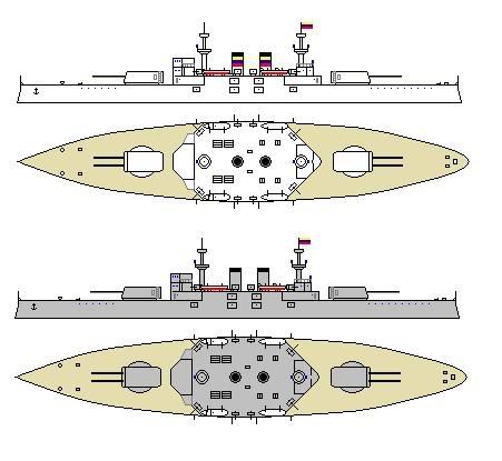

Audaz Class
Gran Colombia's first locally designed and built battleships, following previous acqusition of French-built vessels.
Neither vessel has received a refit since construction, and are clearly wearing out.  Given the rise of new turbine-powered dreadnought-type battleships, no virtue is seen in refitting these ships even for assignment to reserve status.  It is expected that they will be sent to the breakers in early 1908, once the Invencible class has completed trials.
Audaz, BB-01, laid down 1886 - scrapped H1/09
Astuto, BB-02, laid down 1887 - scrapped H2/09
Audaz, laid down 1886
Length, 120.0 m x Beam, 23.0 m x Depth, 7.3 m
11577 tonnes normal displacement (10596 tonnes standard)
Main battery: 4 x 27.0-cm (2 x 2)
Secondary battery: 10 x 14.0-cm
QF battery: 8 x 10.0-cm
Light battery: 4 x 5.0-cm
Weight of broadside: 1495 kg
Main belt, 28.0 cm; bow and stern, 14.0 cm
Upper belt, 14.0 cm
Armor deck, average 4.0 cm
Conning tower, 28.0 cm
Battery armor:
Main, 28.0 cm / secondary, 14.0 cm
QF, 3.0 cm / light guns, 3.0 cm shields
Maximum speed for 7994 indicated kw = 17.21 knots
Approximate cruising radius, 5000 nm / 10 knots
Typical complement: 558-725
Estimated cost, $3.948 million (£987,000)
Remarks:
Relative extent of belt armor, 87 percent of 'typical' coverage.
Ship has slow, easy roll; a good, steady gun platform.
Excellent seaboat; comfortable and able to fight her guns
in the heaviest weather.
Main deck secondary guns subject to being washed down
in a seaway.
Distribution of weights:
Percent
normal
displacement:
Armament ......................... 411 tonnes = 4 pct
Armor, total ..................... 3453 tonnes = 30 pct
Belt 1834 tonnes = 16 pct
Deck 592 tonnes = 5 pct
C.T. 122 tonnes = 1 pct
Armament 906 tonnes = 8 pct
Machinery ........................ 2060 tonnes = 18 pct
Hull and fittings; equipment ..... 4141 tonnes = 36 pct
Fuel, ammunition, stores ......... 1486 tonnes = 13 pct
Miscellaneous weights ............ 25 tonnes = 0 pct
11577 tonnes = 100 pct
Estimated metacentric height, 1.4 m
Displacement summary:
Light ship: 10090 tonnes
Standard displacement: 10596 tonnes
Normal service: 11577 tonnes
Full load: 12315 tonnes
Loading submergence 1909 tonnes/metre
Estimated overall survivability and seakeeping ability:
Relative margin of stability: 1.21
Shellfire needed to sink: 5689 kg = 22.2 x 27.0-cm shells
(Approximates weight of penetrating
shell hits needed to sink ship,
not counting critical hits)
Torpedoes needed to sink: 1.9
(Approximates number of 'typical'
torpedo hits needed to sink ship)
Relative steadiness as gun platform, 87 percent
(50 percent is 'average')
Relative rocking effect from firing to beam, 0.37
Relative quality as a seaboat: 1.73
Hull form characteristics:
Block coefficient: 0.57
Sharpness coefficient: 0.44
Hull speed coefficient 'M' = 5.32
'Natural speed' for length = 19.8 knots
Power going to wave formation
at top speed: 45 percent
Estimated hull characteristics and strength:
Relative underwater volume absorbed by
magazines and engineering spaces: 86 percent
Relative accommodation and working space: 109 percent
Displacement factor: 106 percent
(Displacement relative to loading factors)
Relative cross-sectional hull strength: 0.93
(Structure weight per square
metre of hull surface: 692 kg)
Relative longitudinal hull strength: 2.14
(for 4.80 m average freeboard;
freeboard adjustment +0.05 m)
Relative composite hull strength: 1.01
[Machine-readable parameters: Spring Style v. 1.2.1]
393.60 x 75.44 x 23.94; 15.74 -- Dimensions
0.57 -- Block coefficient
1886 -- Year laid down
17.21 / 5000 / 10.00; Reciprocating -- Speed / radius / cruise
25 tons -- Miscellaneous weights
4 x 10.63; 2; 0 -- Main battery; turrets; superfiring
10 x 5.51; 0 -- Secondary battery; turrets
Main deck battery
8 x 3.94 -- Tertiary (QF/AA) battery
4 x 1.97 -- Fourth (light) battery
0 -- No torpedo armament
11.02 / 5.51 / 5.51 / 0.00; 87 -- Belt armor; relative extent
1.57 / 11.02 -- Deck / CT
11.02 / 5.51 / 1.18 / 1.18 -- Battery armor
(Note: For portability, values are stored in Anglo-American units)

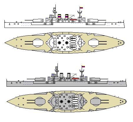

Valiente Class
Larger follow-ons to the Audaz class, with new 30.5 cm guns.  The class is now due for a refit but is unlikely to receive one.  Given their relative obsolescence in comparison to the new dreadnought-type battleships, the class will likely soldier on until being replaced by the soon-to-be-built Triunfante class in 1910-11.
Valiente, BB-03, laid down 1891; deleted to Netherlands, 1911
Insolento, BB-04, laid down 1892; assigned to training, 1911
Valiente, laid down 1891
Length, 124.0 m x Beam, 24.0 m x Depth, 7.3 m
12483 tonnes normal displacement (11551 tonnes standard)
Main battery: 4 x 30.5-cm (2 x 2)
Secondary battery: 12 x 14.0-cm
Light battery: 16 x 5.0-cm
Weight of broadside: 2169 kg
4 TT, 45.7 cm (submerged)
Main belt, 27.0 cm; bow and stern, 9.0 cm
Upper belt, 14.0 cm
Conning tower, 27.0 cm
Battery armor:
Main, 27.0 cm / secondary, 14.0 cm
Maximum speed for 7996 indicated kw = 17.21 knots
Typical complement: 590-768
Estimated cost, $4.622 million (£1.155 million)
Remarks:
Relative extent of belt armor, 93 percent of 'typical' coverage.
in a seaway.
Percent
normal
displacement:
Armament ......................... 597 tonnes = 5 pct
Armor, total ..................... 3749 tonnes = 30 pct
Belt 1914 tonnes = 15 pct
Deck 640 tonnes = 5 pct
C.T. 123 tonnes = 1 pct
Armament 1072 tonnes = 9 pct
Machinery ........................ 1948 tonnes = 16 pct
Hull and fittings; equipment ..... 4586 tonnes = 37 pct
Fuel, ammunition, stores ......... 1579 tonnes = 13 pct
12483 tonnes = 100 pct
Estimated metacentric height, 1.5 m
Light ship: 10904 tonnes
Standard displacement: 11551 tonnes
Normal service: 12483 tonnes
Full load: 13178 tonnes
Loading submergence 2059 tonnes/metre
Relative margin of stability: 1.20
Shellfire needed to sink: 6070 kg = 15.4 x 30.5-cm shells
Relative steadiness as gun platform, 86 percent
Relative rocking effect from firing to beam, 0.46
Relative quality as a seaboat: 1.71
Hull speed coefficient 'M' = 5.36
'Natural speed' for length = 20.2 knots
magazines and engineering spaces: 92 percent
Relative accommodation and working space: 112 percent
Displacement factor: 100 percent
Relative cross-sectional hull strength: 0.92
metre of hull surface: 723 kg)
freeboard adjustment -0.03 m)
Relative composite hull strength: 1.00
406.72 x 78.72 x 23.94; 15.74 -- Dimensions
1891 -- Year laid down
4 x 12.01; 2; 0 -- Main battery; turrets; superfiring
12 x 5.51; 0 -- Secondary battery; turrets
Main deck battery
16 x 1.97 -- Fourth (light) battery
4 / 4 / 17.99 -- TT / submerged / size
10.63 / 3.54 / 5.51 / 0.00; 93 -- Belt armor; relative extent
1.57 / 10.63 -- Deck / CT
10.63 / 5.51 / 1.18 / 1.18 -- Battery armor

Triunfante Class - Final Design
The revised Triunfante class battleships will be laid down in 1909.  A few changes have been made to the design:
-The hull sits a bit lower in the water, so will cost me a bit more.
-The forward turret arrangement has been changed to A-Bs; though the design does not make it clear, it will be a new gun design, too.  Sighting hoods have been removed from the turrets, allowing fire over other turrets.
-Consequently, additional 14 cm guns have been added to the secondary battery, at the expense of tertiary and QF battery guns
-More compact, higher superstructure forward
-Improved armor protection (the belt length reflects what the picture tells me I need, not what the SS report says)
-Slightly faster, with oil-sprayed coal-firing boilers; though the range has gone down, it's acceptable for GC standards.
Top view as originally designed; bottom view as revised and to be built...
Triunfante, BB-13, laid down 1909
Porfiado, BB-14, laid down 1909
Triunfante/Porfiado, to be laid down 1909
